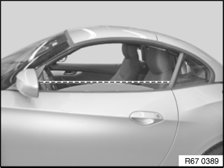

Manual operation:
In this operation it is necessary to place the power window regulator in panic mode to teach in the stiff movement due to the gasket.
3. Simulate exit from the vehicle:
  • Entry through the driver's door
  • Remove ignition key
4. Simulate entry into the vehicle:
  • Open and fully close driver's door
  • Insert ignition key and turn on ignition
5. Fully open door window glass (which is being initialized).
3myvAxRq Warning!
Danger of injury!
The Panic mode function is activated in this operation, This means that the door window glass is closed without an active anti-trap mechanism.
6. Pull and hold power window switch in 2nd stage and have the door window glass reverse in the position shown.
7. Immediately after reversing, release the switch, remove hand from the door window glass area and pull the switch straight away into position 2 again. Keep the switch pulled until the door window glass is fully closed.
1Jvu2xy
8. Remove ignition key and exit vehicle.
9. Continue the service function on the diagnosis system. The Sleep command is sent from the diagnosis system to the footwell module.

  1. Run the automatic testing procedure to learn the top and bottom end positions.
    During the testing procedure, the window opens and closes fully.
    Note: If the window reverses at the top end stop when the diagnosis command “Initialise power window” is running, proceed as follows:
    Open the convertible top and repeat the function for learning the end positions. Then close the convertible top again and continue the service function.
  2. Do not terminate the service functions, rather get into the vehicle via the driver's door.
  3. Switch off the ignition and terminal “R” and then open and close the driver's door (vehicle entry is simulated).
  4. Switch on the ignition (terminal “15”) again and open the window (the one to be initialised) completely.
  5. Place the palms of your hands on the rear end of the door (see marked area (1) in graphic), pull the power window switch into the 2nd position and hold it there. The window moves up and reverses.
  6. Let go of the switch and take your hands off the door. Immediately pull the switch to position 2 again and hold there until the window is closed.
    Important! The window is closed in the “panic mode” function without active anti-trapping protection. Risk of injury!
    This testing procedure teaches the stiff movement of the sealing system.
  7. When the window is closed, switch off the ignition and terminal “R” and get out of the vehicle.
  8. Continue the service function on the diagnostic unit. The diagnostic unit sends the “Sleep Mode” command to the footwell module. The data are stored in the control unit.
