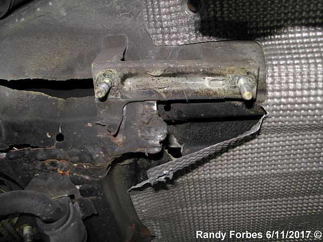

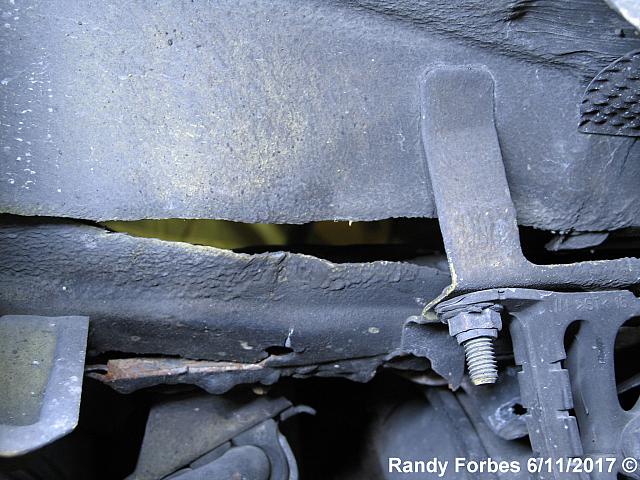

Na een vreemde rammel in mijn Z3 coupe 2.8 hem bij de garage om de hoek op de brug gezet.
Blijkt dat een dwarsbalk van het chassis waar de achterkant van het differentieel aan hangt, is los gekomen van de bodemplaat vervolgens is de dwarsbalk bijna helemaal door gescheurd.
Heeft iemand zoiets wel eens mee gemaakt? en weet iemand hoe en of dit fatsoenlijk te repareren is?
groeten, Bart

Personally, I would contact this man.
HT.
Randy_Forbes
Joined: 29 Jul 2009
Posts: 33
Posted: Sat 20th Mar 18:26 Post subject:
Hi Guys, and thanks Jonttt for pointing me over here.
Aww, that doesn't look that bad, and I've probably fixed worse cars
It also appears as though someone attempted to either fix or hide it...
I do offer a reinforcement package, consisting of 10 ga steel. The best way to describe it, is to say there'll be an I-beam concealed in the hollow crossmember when you're done. That will take care of any flexing or separation of the trunkfloor with regard to the rest of the body. The I-beam will be "hung" off the longitudinal rails that lead from the buklhead to the rear bumper.
LOL! it just occurred to me that the 3D guy put the pendant reinforcements on the wrong sides (see "real" picture below). I'll have this corrected for future drawings, but you get the idea
BTW, the car shown above was in VERY BAD condition, if you want to take a look at the extent of the damage that can be repaired: http://www.rfdm.com/gallery/album161
For the actuall differential mount, you can choose an earlier E-36 M3 pattern dual ear cover, or keep your existing single ear. I prefer the dual ear, but I own one (1) car reinforced each way (S-52 w/single ear & S-54 with the dual setup). My S-52 has been supercharged on and off, and the reinforced single ear (two OE mounts sandwiched together) is doing the job.
The complete job on Andy's car: http://www.rfdm.com/gallery/album181
If you have any questions, I will be happy to answer them for you. If you send me an E-mail ( erandyforbes@aol.com ) I will reply with a pdf that outlines the work involved.
If you want a shipping/price quote, please provide me with your complete address, and I will get a UPS quote.
The very complete & comprehensive installation instructions are included electronically, and I will always be happy to answer any questions you or your installer may have before, during ,or after the installation.
Because International shipping is expensive, I offer a trade discount (20% off the $540.00 USD price) to all overseas orders. That goes a long way ($108.00USD's worth) towards offsetting the shipping cost.
Thanks again, and I hope you will give it some consideration.
Randy

Dat zijn behoorlijke nachtmerrieplaatjes.....
